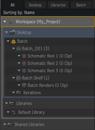

Tab Navigation
The top of the Media panel displays a number of tabs. Click a tab to focus on a specific area of interest in the Media panel.
- All
- Displays all areas of the Media panel: Desktop, Libraries, and Batch.
- Desktop
- Displays each instance of Batch, along with their schematic reels, shelves, and iterations.
- Libraries
- Displays only the Libraries and Shared Libraries folders.
- Batch
- Displays only the currently-active Batch, along with its schematic reels, Batch shelf, and iterations.
- Conform
- Only available while working in Conform, replacing the Batch tab described above. Displays only media available for the conform, filtered by match criteria.
- BFX
- Only available while working in Batch FX, replacing the Batch tab described above. Displays only media used in Batch FX.
