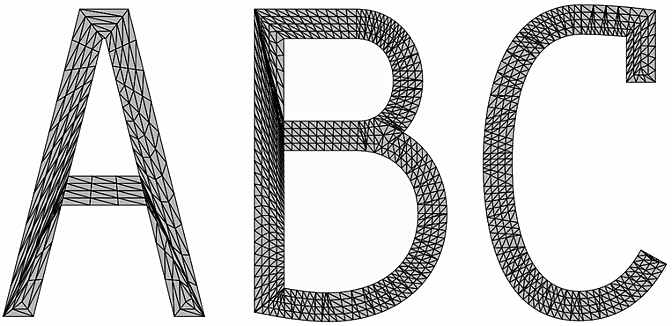

Tessellation is the process of tiling the curves' shapes with polygons. Flame Assist offers different tessellation methods for use with 3D Text:
Standard (GLU) is the fastest tessellation option, although it is also the least efficient.
Delaunay generates a mesh composed entirely of triangular polygons. This method gives consistent and predictable results, and in particular, it will not give different results if the tessellated objects are rotated.
Medial Axis creates concentric contour lines along the medial axes (averages between the input boundary curves), morphing from one boundary shape to the next.
The Wireframe box is also provided in the Tessellation menu. It is the same setting as in the Geometry tab, but repeated here for ease-of-use.
Each method has its own set of options, described in the sections that follow.

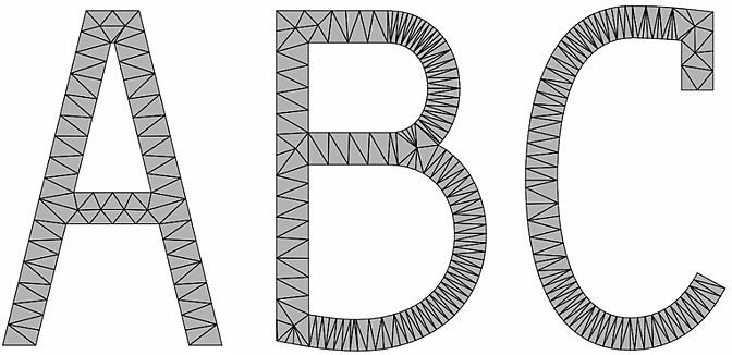

The Delaunay tessellation method (or more precisely, constrained Delaunay tessellation) generates a mesh composed entirely of triangular polygons. This method gives consistent and predictable results, and in particular, it does not give different results if the curves are rotated.
With this method, there are several options for fine-tuning the tessellation further.
Min Angle = 20
Max Area = 5
Use this option as a precaution against accidentally setting the other options to values that would create huge amounts of geometry with long processing times.
It is not recommended that you rely on this option to control the final number of vertices because it can force the tessellation to stop before the process is completed, thereby giving an unpredictable combination of polygon shapes and sizes.

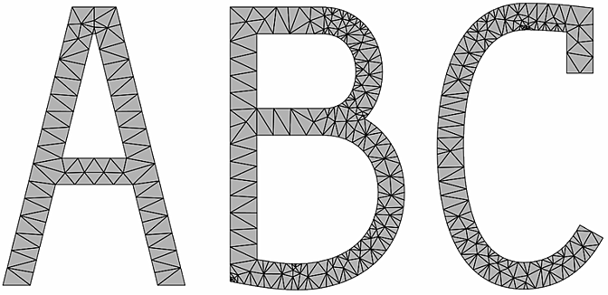

| Select: | To: |
| Free | Allow the boundary edges along the outer contour and inner holes to be split further during tessellation. This is particularly useful for text and other shapes that may contain straight edges that need to be deformed smoothly. |
| None (Contour Only) | Allow boundary edges along inner holes to be split, but not boundary edges along the outer contour. Note that this may affect the uniformity of the mesh if you enabled Min Angle or Max Area. |
| None (Contour and Holes) | Prevent any boundary to be split. Note that this may affect the uniformity of the mesh if you enabled Min Angle or Max Area. |

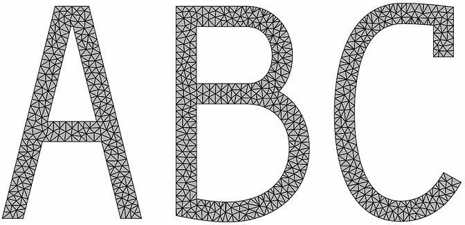

The Medial Axis tessellation method creates concentric contour lines along the medial axes (averages between the input boundary curves), morphing from one boundary shape to the next. This method creates mainly quads with some triangles, so it is well-suited for subdivision surfaces.
Loops = 2
| Set to: | To have: |
| 0 | The medial axis intersects boundaries at each point of concavity, which can often create many small triangles especially in sharp extremities. |
| Positive value | The medial axis does not extend completely to the boundary and the remaining area is tessellated with a fan shape. |
| Negative value | Sharper embossing effects |
| Select: | To: |
| None | Have long edges that are not split. This results in fewer polygons and lighter geometry, but the resulting long, thin polygons may not deform well. |
| Equal on Both Sides | Have a tessellation made of squarer polygons that deform better, at the cost of a heavier tessellation. |
