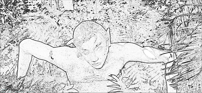

Use Stylize on an image sequence to create a wide range of visual styles, including painting, printing and sketching. Stylize allows you to build your look by stacking layers with different effects.
Stylize includes a collection of 10 core effects that are stacked and blended together as layers. The core effects fall into four major categories: canvas texture, patterns, colour fillings, and outlines. Each of the core effects has its own settings, which display when an effect is selected:
Since the possible combinations of core effects are endless, over 80 presets are available to help you get started with Stylize. These presets can also help you learn how Stylize layer stacking works. The presets are divided into a number of categories and are easily added to your scene.
