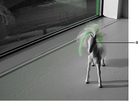

    The initial softness and tolerance is set for the matte. The range you use to define the matte becomes visible through the greyscale image. The unselected colours remain greyscale.
    (a) Original colour visible through the greyscale display. 

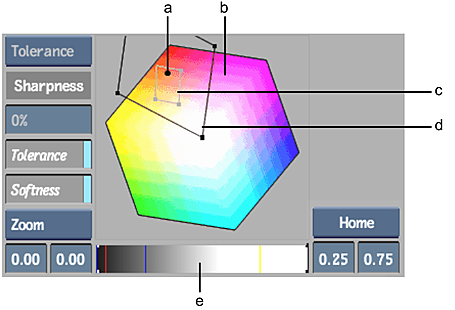

  5. Enable Tolerance and Softness.
    The range of colour used to define the matte is shown on the hue cube with tolerance and softness indicators. The light grey outline shows tolerance and the black outline shows softness. When you define a matte with a luma range, it is shown in the luma range—the white line indicates the tolerance and the yellow line indicates softness.
    (a) Plotted colour (black dot)  (b) Hue cube  (c) Tolerance range  (d) Softness range  (e) Luma range  

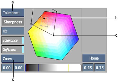

    • Adjust softness and tolerance by selecting Move from the Move/Zoom box and then moving the handles of the tolerance or softness outlines on the hue cube. The Tolerance and Softness buttons must also be enabled.
    (a) Adjusting box  (b) Tolerance handle  (c) Softness handle  (d) Move/Zoom box  
    Tip: You can zoom the hue cube by selecting Zoom in the Move/Zoom box and then dragging the cube. Alternatively, Ctrl+spacebar-drag to zoom. You can pan the hue cube by pressing spacebar and dragging.
