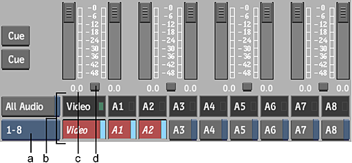

(a) Audio Tracks Toggle button (b) Channel Selection buttons and indicators (c) Audio Level fields (d) Fader Lock buttons  
All Audio button
When enabled, outputs to the audio monitor every audio channels. When disabled, outputs only the enabled audio channels to the audio monitor. The All Audio button has no impact on the audio tracks recorded by the VTR.
Toggles the Channel Selection buttons and indicators between audio tracks 1-8 and 9-16.
Controls and displays which audio channels are recorded by the VTR. The black boxes with the green LEDs indicate video tracks and audio channels that are part of the clip that you want to output. The red buttons indicate the tracks and channels the VTR records on output.
Audio Level fields
Displays the audio gain, in decibels. Adjust using the faders. In the small VTR Output module, increase or decrease the gain by dragging left or right on the fields. By default, audio gain is 0 db.
Fader Lock buttons
When enabled, locks the faders for the corresponding pair of audio channels together.
