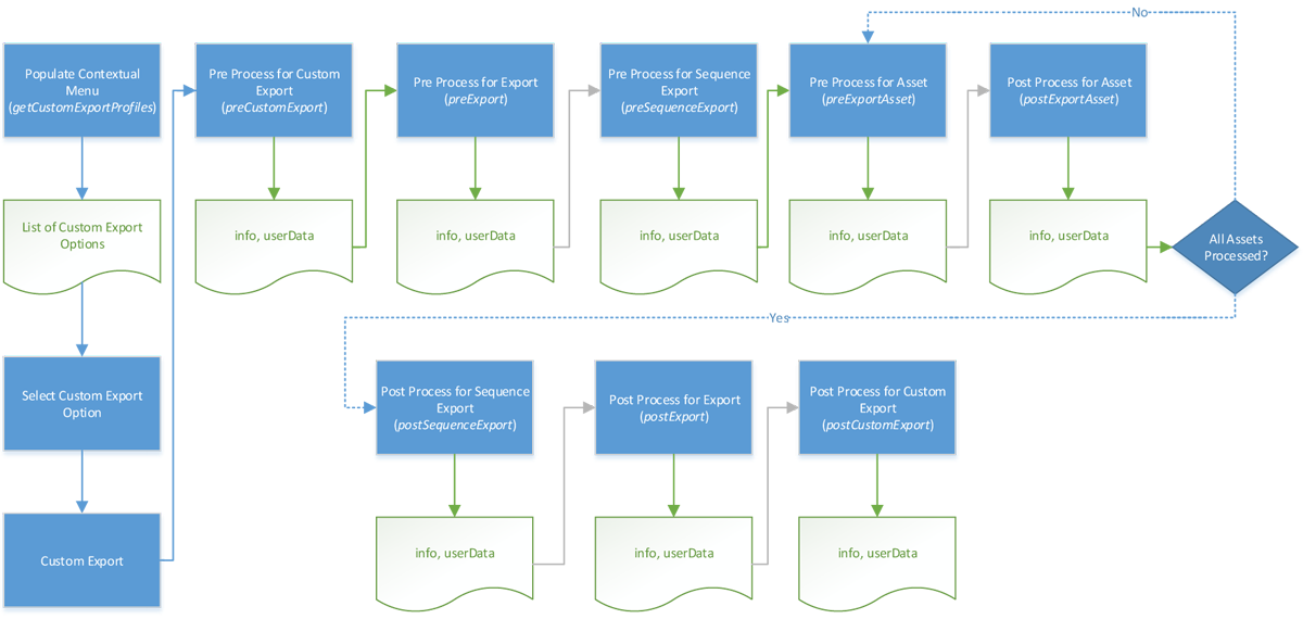

Export Hooks
Located in the exportHook.py.
These hooks are used when the user exports from the application.
Export hooks are called in the following order:
Note: In the following descriptions, some dictionary keys have the [Modifiable] keyword. This indicates that assigning a value to this key will overwrite the key's original value. Keys without the [Modifiable] keyword have read-only values.
Export Hook Example
The info dictionary contains the information set by the selected preset, be that by the contextual menu defined by getCustomExportProfiles, or by the preset selected by the user in the Export window.
This means that for regular exports, the user either uses one of the presets, or inputs the required information in the Export dialog box. For custom exports, the getCustomExportProfiles get the actual profile use, based on the contextual menu defined within.
Note: To create an export profile, access the Export dialog, and save a new Format Preset.
def getCustomExportProfiles( profiles ):
profiles['Create Stuff']= '/usr/discreet/flamepremium_2015.2.pr45/export/presets/CustomExport.xml'
When performing a regular export through the Export window, use preExport to validate or overwrite settings that the user might have changed. This ensures the exported information is correctly output, to the correct directory.
def postExportAsset( info, userData ):

preCustomExport
Called before a custom export begins, just after the user clicks the Export button. The export is blocked until the function returns.
def preCustomExport( info, userData ):
   pass

postCustomExport
Called after a custom export ends. The export is blocked until postCustomExport returns.
def postCustomExport( info, userData ):
   pass

preExport
Called before an export begins
def preExport( info, userData ):
   pass

preExportSequence
Called before an sequence export begins. The export is blocked until this function returns.
def preExportSequence( info, userData ):
   pass

postExportSequence
Called after a sequence export ends. The export is blocked until this function returns.
def postExportSequence( info, userData ):
   pass

preExportAsset
Called before an asset export begins. The export is blocked until this function returns.
def preExportAsset( info, userData ):
   pass

postExportAsset
Called after an asset export ends. The export is blocked until this function returns.
   pass
