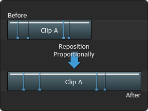

| Reposition Proportionally
Resize the channel as you trim. The animation channel is scaled to fit into the timeline element. This option has no effect when you slip or slide.

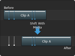

| Shift With Media
Link the keyframes to their original frame numbers. The animation channel moves to follow the original frames as you trim.

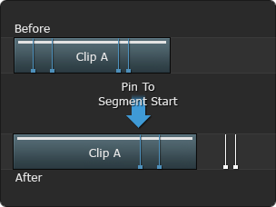

| Pin To Segment Start
Unlink the keyframes from their original frame number. The animation channel remains with the timeline element as you trim.
