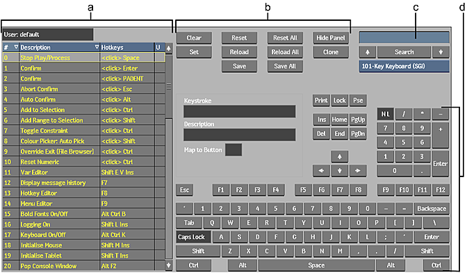

Accessing the Keyboard Shortcut Editor
Use the Keyboard Shortcut Editor to view, modify, and create keyboard shortcuts.
To access the Keyboard Shortcut Editor:
  1. From the Flame Assist menu, select Keyboard Shortcuts.
(a) Keyboard Shortcut Catalogue  (b) Keyboard Shortcut Manager  (c) Search Field    (d) Keystroke Editor
