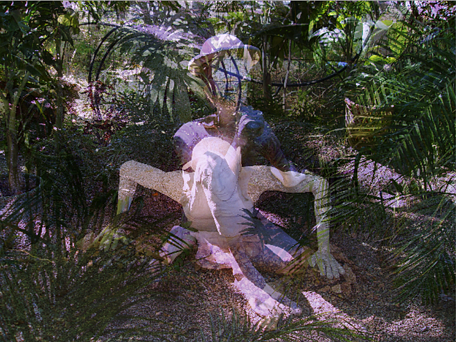

Use Blend & Comp to apply basic blending and compositing between two inputs, and their mattes, over a background.

This node accepts up to two front and matte clips, as well as a back clip, and outputs a result and outmatte.
