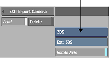

To import a 3ds Max camera:
  1. In the Camera menu, click Import.
    The Import Camera file browser appears.
  2. From the Import Type box, select either the .3DS or .ase format.
  3. If needed, enable Rotate Axis to rotate the imported camera by 90° on the X-axis so that it is compatible with Action's coordinate system.
  4. Navigate to the location where a 3ds Max camera setup was exported, and select the file.
    You return to Action and the imported camera is applied to your scene.

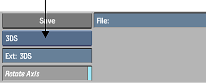

To export a camera to 3ds Max format:
  1. Select the camera you want to export.
  2. In the Camera menu, click Export.
    The Export Camera file browser appears.
  3. From the Export Type box, select 3DS.
  4. If needed, enable Rotate Axis to rotate the exported camera by -90° on the X-axis so that it is compatible with the coordinate system of the 3D application.
  5. Navigate to the location where you want to export the camera animation.
  6. Enter a name for your exported camera in the file field.
  7. Click Save.
