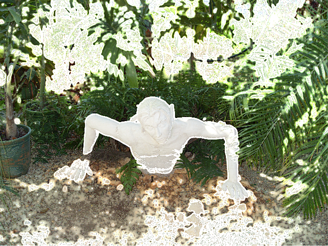

Use Pixel Spread to create a stretching effect from the image edges delimited by a matte. This can be useful to solve keying problems resulting from dark edges around the area to be keyed, for example.
