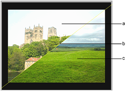

You can use the split bar to view and sample a reference clip while you work. Reference clips are particularly useful when you want to match colours or compare colour corrections. Carefully selecting a suitable reference clip will help you make your colour corrections quickly and efficiently. For example, you can use a reference clip from the Batch FX schematic to match saturation, whites and blacks, or colours. You can also switch between different references to ensure continuity throughout the project.
(a) Focus clip  (b) Split bar  (c) Reference clip  
