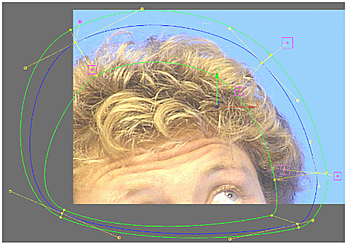

To assign pickers to selected vertices:
  1. From the Edge Softness box, select Tracer.
    The Tracer menu appears, and two softness borders (the green lines) are added to the mask.
    (a) Edge Softness box  
  2. Select the vertices to which you want to apply pickers. See Selecting Vertices and Tangents.
  3. Enable Pickers.
    Note: When one or more pickers are enabled, mask characteristics are automatically set to Outside disabled and a Colour value of 0 so that the mask will be white inside and black outside. Do not set the Outside button unless you want to reverse the effect.
    A pair of pickers is provided for each selected vertex.
    (a) Softness borders  (b) Picker  
    • On vertices without pickers, the softness borders delineate the area where a softness gradient is applied.
    • On vertices with pickers, the softness borders delineate the area to which softness is applied according to the picker values.
To fine-tune the matte:
  1. Adjust the softness borders and mask border by moving the vertices and tangents:
    • The mask border should follow the general contour of the subject as closely as possible.
    • The outer softness border should completely surround all details that you want to include in the matte—all wispy details and edges must be within this line.
    • The inner softness border should be well within the area where softness control is needed.
    When moving tangents, you can opt to have the pickers follow the tangent movement (the default behaviour), or be independent of tangent movement. To make pickers independent of tangents, switch to Break mode and click either picker. You can animate this behaviour. See Animating a Tracer Mask.
    Note: If the tangents are broken, the pickers are automatically unlinked from the tangents.
  2. For each pair of pickers, one requires a sample of the area outside the mask, while the other requires a sample of the mask interior.
    Place one picker outside the subject to sample values you do not want to include in the matte (for example, a blue screen). Place the other picker within the subject for a colour value sample of an area you do want included in the matte. Try to select areas where the colour values do not change too much throughout the clip.
