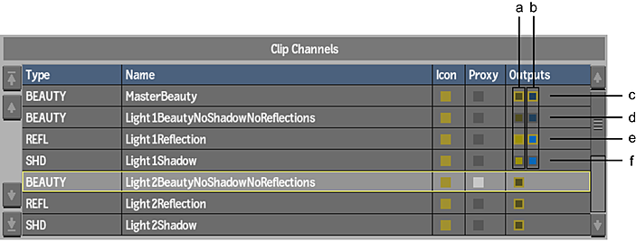

Extended Settings
- Extended button
- Opens the Extended menu where you set the channel options, from the channel displayed in the node proxy to the available outputs.
Note: With a Read File clip selected in the schematic, press Ctrl+C to expand the node and display its channels in the schematic.
(a)Media output (b)Alpha output (c) Displayed and disconnected outputs (d)Hidden and disconnected outputs (e) Displayed and connected outputs (f) Hidden but connected outputs
- Type field
- Displays the type of channel. Non-editable.
- Name field
- Displays the name of the channel. Non-editable.
- Icon field
- Enable to display the channel in the schematic; disable to hide the channel. The Read File clip must be expanded (press Ctrl+C) to view the channels in the schematic. Hiding a channel does not break its link to a node.
- Proxy field
- Enable to use a particular channel as the Read File clip proxy in the schematic.
- Outputs fields
- Click to display or hide the outputs available for each channel from the Read File clip in the schematic. Hiding an output does not break its link to a node. There is one output each for RGB and its alpha (if any).
