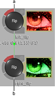

A green-arrowed dotted line indicates that the nodes are linked as duplicates. The direction of the arrow indicates which node is the master.
(a) Duplicate link (b) Master node (b) Duplicate link (d) Duplicated nodes

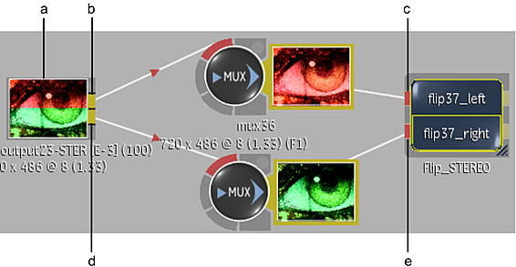

- Connect the left and right eye inputs of the stereo group node to the clip node’s left and right eye outputs, as shown in the following example.
(a) Clip containing stereo track (b) Left eye output tab (c) Left eye input tab (d) Right eye input tab (e) Right eye output tab

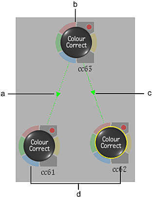

The schematic is dimmed except for the two nodes of the same type as the one you dragged from the node bin. A green-arrowed dotted line indicates that the nodes are linked as mimics.
(a) Master node (b) Mimic link (c) Mimicked node
