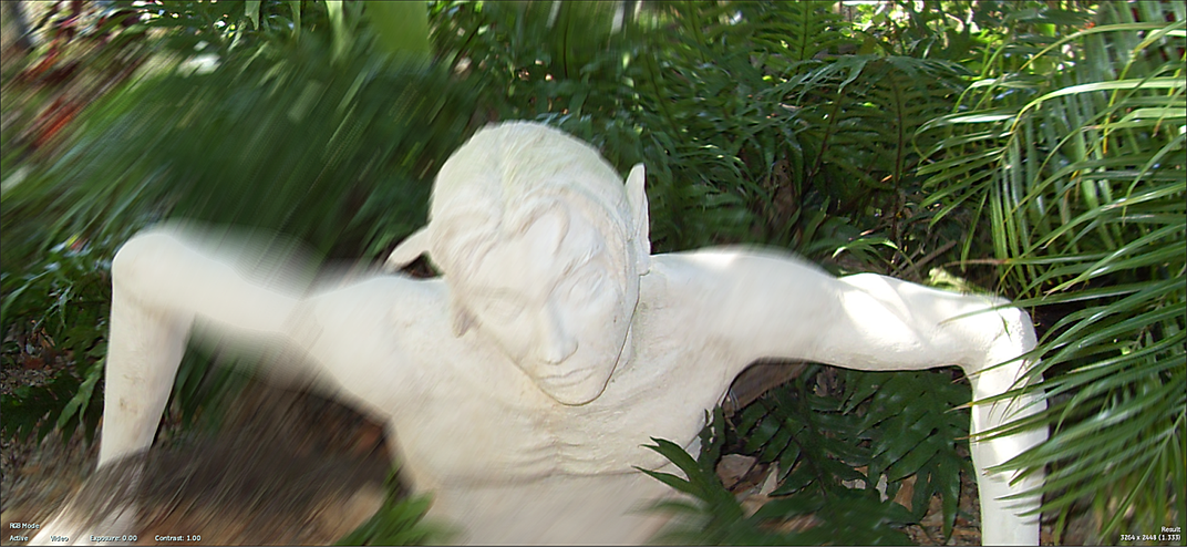

Use Motion Blur to simulate the blur created by fast moving objects.
To access the Motion Blur menu, use:
Timeline, then use Batch FX (see Creating Batch FX).
Tools, then select from the menu (See Accessing Tools).
This node accepts front, matte and forward vector clips and outputs a result, outmatte, or forward Vector clip.
