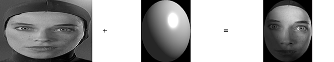

| Wrap (Geom UVs) Wrap mapping completely envelops the 3D model with the diffuse map according to the object’s diffuse coordinates. To use this option, you must import a model that has its own diffuse coordinates. When using Wrap mode, you can also apply UV mapping settings from the Geometry menu. See UV Map Settings.

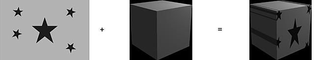

| Plane Planar mapping applies the diffuse map without distorting the front plane of the 3D model, similar to a movie projector casting an image onto a screen. All 3D coordinates of the geometry are mapped to this plane to generate the diffuse values. Planar mapping positions the lower-left corner of the diffuse map on the 3D model’s axis. When you apply planar mapping, any surfaces on the 3D model perpendicular to the front plane cause the pixels at the edge of the texture to project along the “sides” of the object.
