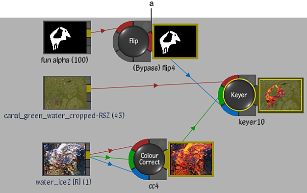

    Note: The Flip node, which was selected in step 1 of this example, has input tabs for a front source. Therefore Front is the only option in the Bypass box.
    The output tab of the bypass node changes colour. In the following example, the tab turns red indicating that the Front input is passed to the next node in the tree. As well “(Bypass)” is added to the node name.
    (a) Output tab of bypassed Front input

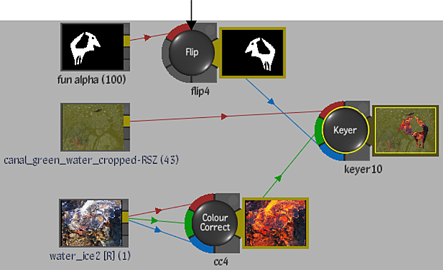

To unbypass nodes:
  1. Do any of the following:
    • Select the node with the bypassed input and disable the Bypass button.
    • If the bypassed node is part of a multi-selection in the schematic, click Disable Bypass On Selection.
    Note: Click Restore Bypass On Selection to redo the bypass.
