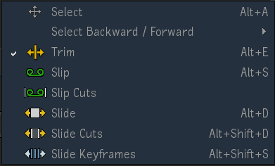

  2. In some cases where dropdown list items have separate keyboard shortcuts, the list items display the various shortcuts.
