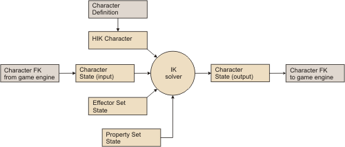

Inverse kinematics
To use the HumanIK inverse kinematics solver, you must provide:
- An HIKCharacter that represents your character.
- An HIKCharacterState that contains the current FK position and rotation of each of your character’s Nodes
within your game engine.
- An HIKEffectorSetState that contains the target position and rotation for your character’s body parts.
- An HIKPropertySetState that provides a variety of parameters and configuration settings for the character.
The solver stores the resulting pose for your character in the same HIKCharacterState you provided with the character’s starting pose.
This data flow is summarized in the following diagram:
