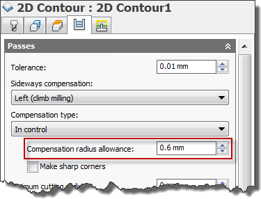

Inventor HSM Express solves these problems by introducing the Compensation radius allowance setting on the Passes tab.
This parameter specifies a range of tool diameters that can be safely used instead of only the tool selected for the operation. The allowed range of tool radii start from the selected tool radius and goes up to the selected tool radius plus the given allowance.
Observe that sharp corners in the selected geometry are rounded by this allowance. Therefore, the parameter should not be set higher than necessary. However, the rounding is not always undesired since the machine can maintain a higher feed at these corners.
This parameter will give slightly different results compared to other CAM systems for simple examples, but it also guarantees that the CNC control can run the generated toolpath for arbitrarily complex geometry.
