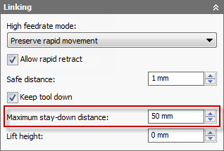

Inventor HSM Express lets you control when you want to keep the tool down by setting Maximum stay-down distance which reduces the number of retracts. This setting is located on the Linking tab.
Enabling the Keep tool down check box and regenerating the toolpath operation shown below, produces the following results.
A 2D Pocket toolpath with a "short" and a "longer" stay-down distance
Remember: For 2D Contour and 2D Pocket, you have to activate the Keep tool down check box to set the Maximum stay-down distance value. For the remaining strategies, Keep tool down is always active but you can set stay-down distance to 0 to always force retracts.
