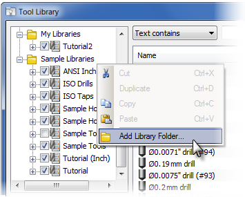

If you wish to keep your tool libraries in a different folder on your PC, or on a network share, you can add additional library folders by right-clicking in the library tree and selecting Add Library Folder from the pop-up context menu.
Adding a library folder
