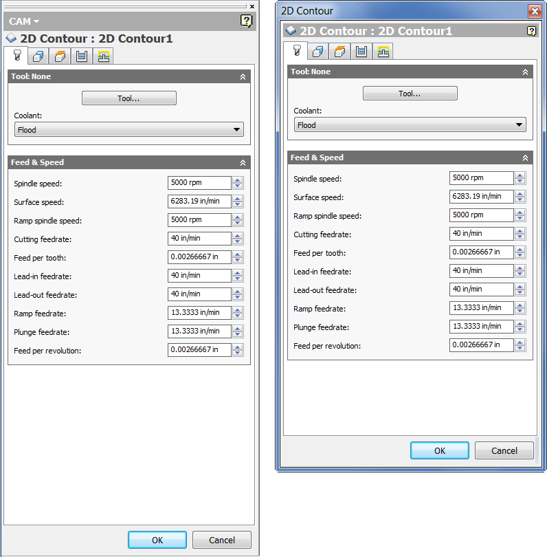

Operation Dialog Position Options
Normally, the Operation dialog box shares the same space as the CAM Browser. You can separate the Operation dialog from the CAM Browser so that it can float freely or be docked to a more convenient location by doing the following:
The next time a machining strategy is selected, the Operation dialog box will display independent of the CAM Browser.
At the left, the Operation dialog box shares the same space as the CAM Browser. At the right, it is shown separated from the CAM Browser in a floating state.

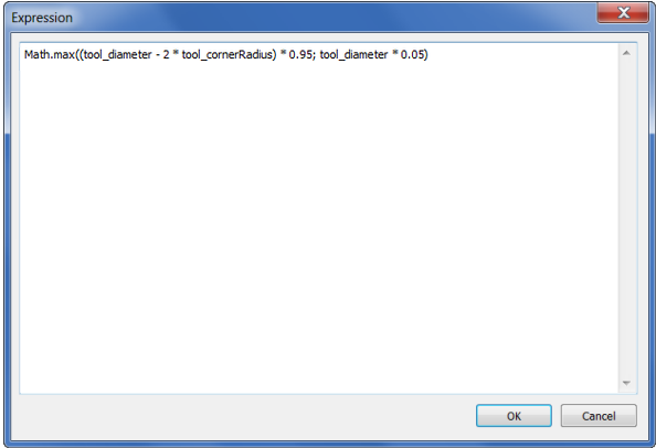

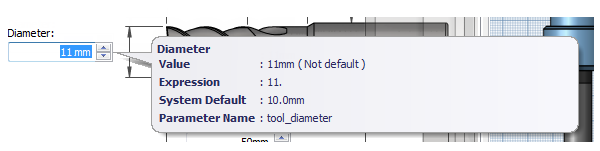

Making and Resetting Parameter Defaults
As far as possible, Inventor HSM Express provides working default values for each of the strategy parameters found in the Operation dialog box. You can control the default values of each parameter by right-clicking over the parameter name to display the pop-up context menu shown below.
The current parameter name (in bold) is displayed at the top of the pop-up context menu. The remaining menu items offer the following options:
