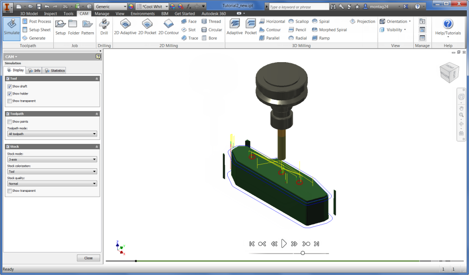

After generating a toolpath, you can inspect the result with the integrated Simulate tool. Using the Play feature, the movement of the tool is simulated. The many controls include simulation speed and direction, visibility of tool, shaft and tool holder as well as the coloring of rapid moves, lead moves, and cutting moves.
The features on the Simulate Info and Statistics tabs allow you to measure distances or dynamically view all the vital information about tools, feed/speed, estimated machining time, etc. Full 3+2 machining is supported, and multiple toolpaths can be inspected in a single operation.
Stock Simulation
The integrated Stock Simulation allows you to see the actual stock being removed from a solid block of material, and to automatically check for shaft and clamp/fixture collisions. The resulting solid model can be inspected by coloring the surface according to the tool that cuts each part of the surface.
