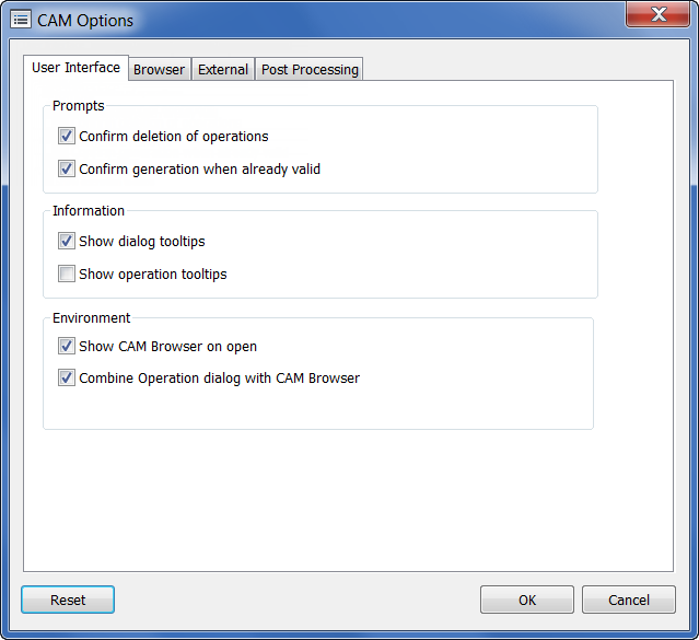

The CAM Options dialog box is comprised of four tabs with settings that allow you to adjust various behaviors within Inventor HSM Express.
The CAM Options dialog box. You can restore the default settings at any time by clicking the Reset button that appears on each tab.
User Interface tab
- Confirm deletion of operations - Displays a prompt asking you to confirm the deletion of a selected operation from the CAM Browser.
- Confirm generation when already valid - You are prompted to proceed with a regeneration when the toolpath is already valid.
- Show dialog tooltips - Shows tooltips for the controls in a dialog box.
- Show operation tooltips - Hover your mouse over a node in the CAM Browser to display machining details (description, strategy, tool description, etc.) for the selected node.
- Show CAM Browser on open - Display the CAM Browser and the CAM ribbon when a document containing CAM data is opened.
- Combine Operation dialog with CAM Browser - Normally the Operation dialog shares the same window as the CAM Browser. Disable this setting to view the Operation dialog as a separate and dockable window.
