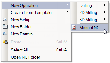

from the ribbon. You can also right-click anywhere in the CAM Browser and select New Operation from the pop-up context menu.
Accessing Manual NC from the New Operation context menu
Then select Manual NC from the menu, and choose the appropriate type of NC entry from the Manual type: drop-down menu.

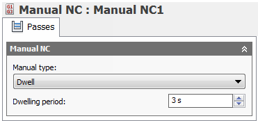

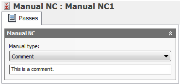

Editing two types of Manual NC entries: Comment and Dwell
