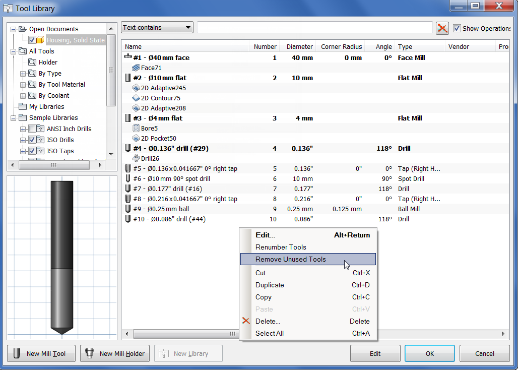

Inventor HSM Express lets you easily remove all the unused tools by right-clicking the library or tool list and choosing Remove Unused Tools from the pop-up context menu.
Example part before removing unused tools

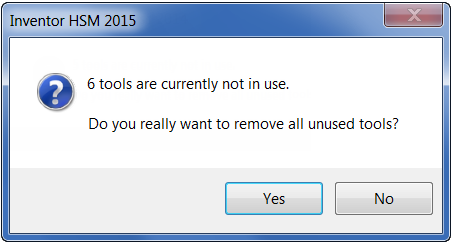

Remove unused tools prompt

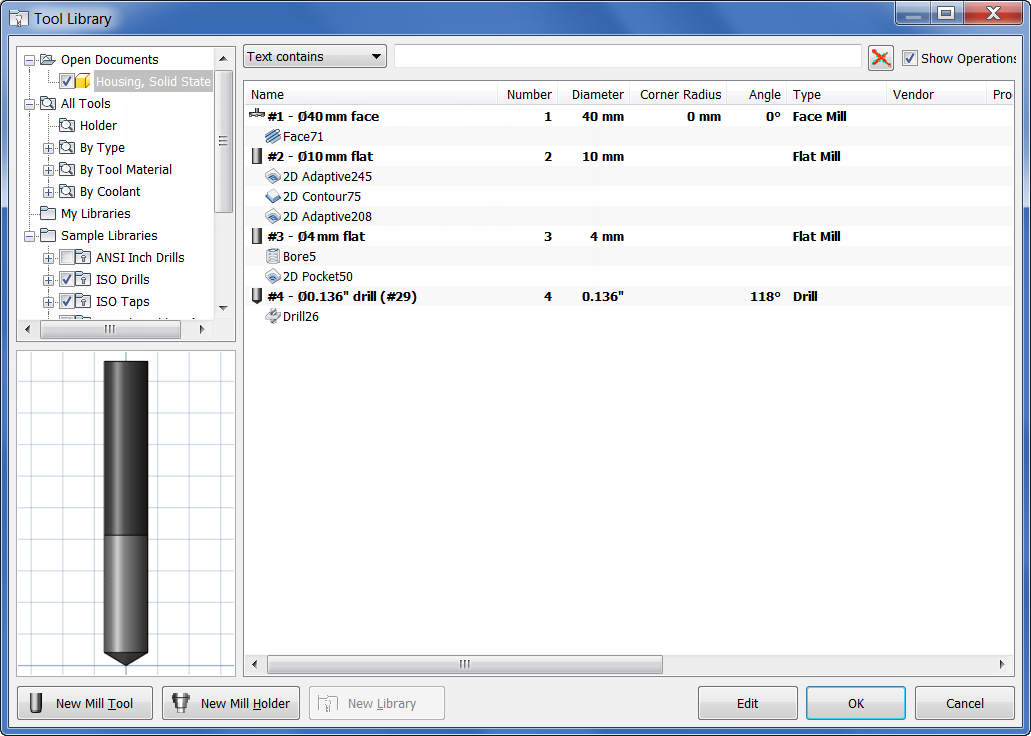

Example part after removing unused tools
