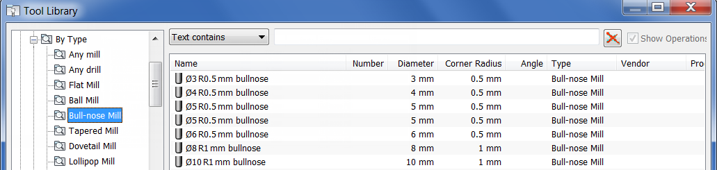

For example: By selecting the By Type > Bull-nose Mill folder, only the bull-nose tools are shown.
Showing only Bull-nose tools

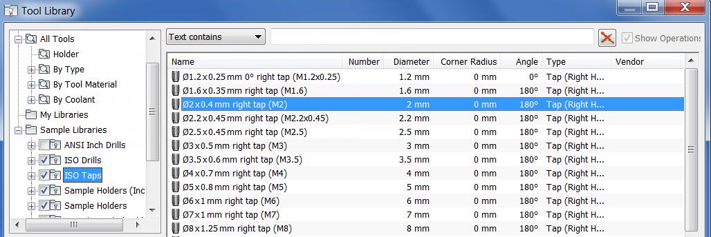

Excluding the tools from the Sample Libraries

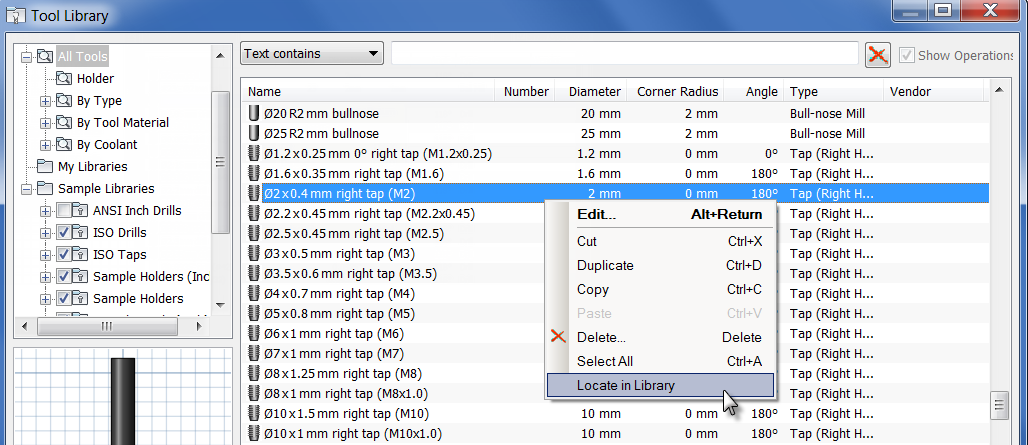

When using the Search Folder function, you may want to open the corresponding library in which a given tool is stored. Simply right-click the tool and choose Locate in Library from the pop-up context menu.
The Locate in Library option

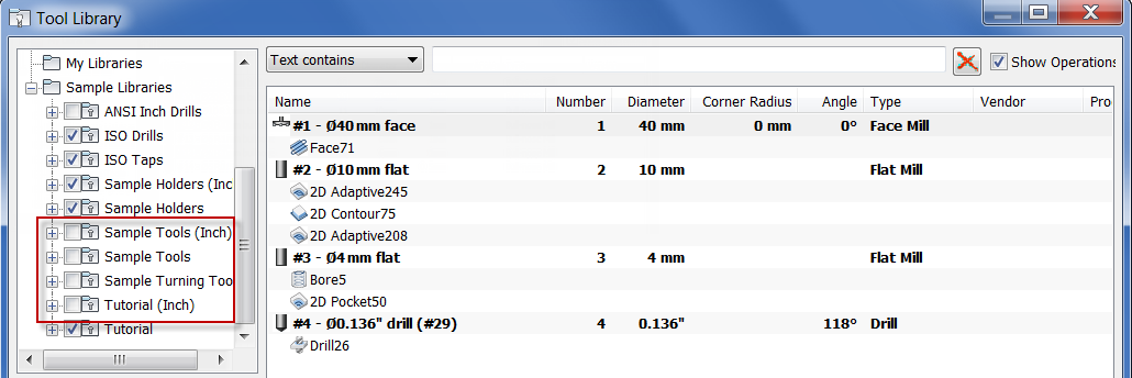

This selects the library in the tree and locates the tool.
