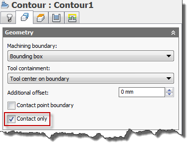

Most of the 3D finishing strategies in Inventor HSM (Contour, Parallel, etc.) have a setting called Contact only on the Geometry tab.
The Contact only setting
Contact only controls whether or not a toolpath should be generated when the tool is not in contact with the machining surface. By default, the option is enabled and produces a toolpath similar to that shown below:
