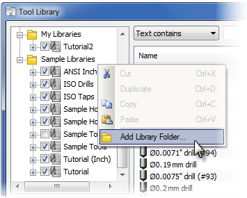

If you wish to keep your tool libraries in a different folder on your PC, or on a network share, you can add additional library folders by right-clicking in the library tree and selecting Add Library Folder from the pop-up context menu.
Adding a library folder
You are then presented with a standard Browse for Folder dialog box that lets you select an existing folder or create a new one. After adding the folder, you can give the folder an appropriate name. In the image below, the new library folder has been renamed Tool Libraries on Server to indicate that the tool libraries reside on the server.
