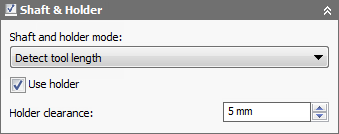

Detect tool length
With this option selected, Inventor HSMautomatically calculates the minimum tool length required to keep the holder free of the part with a given Holder clearance. When the toolpath is calculated, the "Body length" of the tool definition is updated to the minimum length required.
Setting Detect tool length with a holder clearance distance of 5 mm

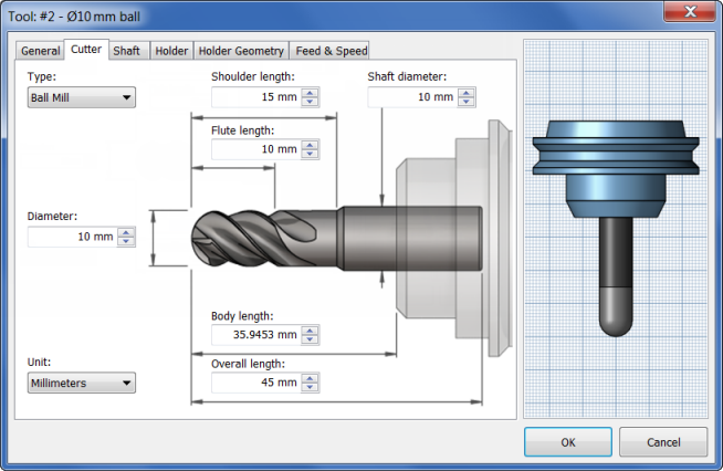

The following warning is output to the log when generating the toolpath with Detect tool length active and the tool is too short: Warning: The tool length has been updated from 25 mm to 35.9453 mm to ensure that the holder doesn't collide with the part.

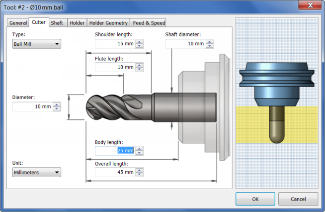

At the same time, the tool is updated.
The original tool
The updated tool
