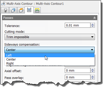

Multi-Axis Contour allows you to compensate the tool to the left and right side of the selected contours.
Sideways compensation direction
This works exactly like the compensation direction available on the 2D Contour strategy, and offsets the tool to the left or right of the selected geometry.

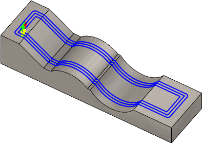

Left/Center/Right compensated Multi-Axis Contour toolpaths
