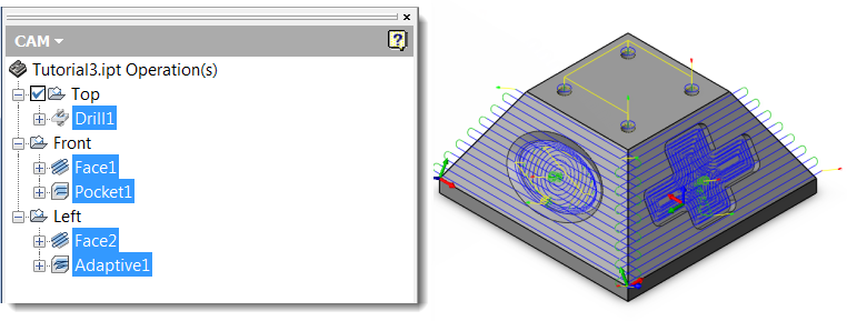

Setup
A Setup defines a number of general properties for a set of machining operations - including the work coordinate system (WCS), the stock geometry, fixtures, and the machining surfaces.
Every setup is represented as a separate item in the CAM Browser using the Setup icon
. Any operations located under this item use setup settings by default.
Setup on the Inventor HSM toolbar, or from the CAM Browser pop-up context menu.
A 3+2 part with a setup for each side to be machined
