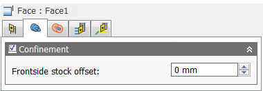

Geometry tab settings
Toolpaths can be contained within a specific region using the Confinement button to select confinement boundaries. Confinement regions can be defined with a combination of edges, surfaces, or sketch points.
Specifies the distance to machine beyond the frontside of the model.
Negative Frontside Offset
Positive Frontside Offset

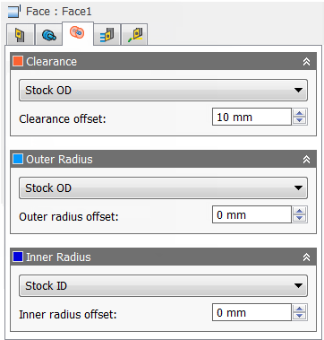

Heights tab settings
Set this height to control the radius where the tool enters and exits the toolpath. The tool approaches and retracts from inside the stock along the Z axis (spindle axis) at this radial clearance offset. The value displayed on the orange tab represents its current radius relative to the setup axis.
Outer Clearance Radius
Specifies the clearance offset value.
Outer Clearance Offset
Defines the radial confinement by limiting the outer radial range of the toolpath. You can choose from the following:
Outer Radius
Specifies the outer radius offset value.
Defines the radial confinement by limiting the inner radial range of the toolpath. You can choose from the following:
Inner Radius
Specifies the inner radius offset value.

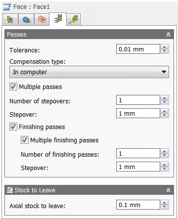

Passes tab settings
The machining tolerance is the sum of the tolerances used for toolpath generation and geometry triangulation. Any additional filtering tolerances must be added to this tolerance to get the total tolerance.
Loose Tolerance .100
Tight Tolerance .001
CNC machine contouring motion is controlled using line G1 and arc G2 G3 commands. To accommodate this, CAM approximates spline and surface toolpaths by linearizing them; creating many short line segments to approximate the desired shape. How accurately the toolpath matches the desired shape depends largely on the number of lines used. More lines result in a toolpath that more closely approximates the nominal shape of the spline or surface.
Data Starving
It is tempting to always use very tight tolerances, but there are trade-offs including longer toolpath calculation times, large G-code files, and very short line moves. The first two are not much of a problem because Inventor HSM calculates very quickly and most modern controls have at least 1MB of RAM. However, short line moves, coupled with high feedrates, may result in a phenomenon known as data starving.
Data starving occurs when the control becomes so overwhelmed with data that it cannot keep up. CNC controls can only process a finite number of lines of code (blocks) per second. That can be as few as 40 blocks/second on older machines and 1,000 blocks/second or more on a newer machine like the Haas Automation control. Short line moves and high feedrates can force the processing rate beyond what the control can handle. When that happens, the machine must pause after each move and wait for the next servo command from the control.
Specifies the compensation type.
Enable to enter a stepover value.
The number of roughing steps.
Specifies the horizontal stepover between passes. By default, this value is 95% of the cutter diameter less the tool corner radius.
Horizontal stepover
Enable to perform finishing passes using the side of the tool.
Finishing passes on
Finishing passes off
Enable to specify more than one finishing pass. If Finishing Passes is enabled, but Multiple Finishing Passes is disabled, then only one finishing pass is performed.
Multiple finishing passes on
Multiple finishing passes off
Specifies the number of finishing passes.
Shown with three finishing passes
The maximum distance between finishing passes.
Positive
Positive Stock to Leave - The amount of stock left after an operation to be removed by subsequent roughing or finishing operations. For roughing operations, the default is to leave a small amount of material.
None
No Stock to Leave - Remove all excess material up to the selected geometry.
Negative
Negative Stock to Leave - Removes material beyond the part surface or boundary.
The Axial stock to leave parameter controls the amount of material to leave in the axial (along the Z-axis) direction, i.e. at the end of the tool.
Both radial and axial stock to leave
Specifying a positive axial stock to leave results in material being left on the shallow areas of the part.
For surfaces that are not exactly horizontal, Inventor HSM interpolates between the axial and radial (wall) stock to leave values, so the stock left in the axial direction on these surfaces might be different from the specified value depending on surface slope and the radial stock to leave value.
Changing the radial stock to leave automatically sets the axial stock to leave to the same amount, unless you manually enter the axial stock to leave.
For finishing operations, the default value is 0 mm / 0 in, i.e. no material is left.
For roughing operations, the default is to leave a small amount of material that can then be removed later by one or more finishing operations.
Negative stock to leave
When using a negative stock to leave the machining operation removes more material from your stock than your model shape. This can be used to machine electrodes with a spark gap, where the size of the spark gap is equal to the negative stock to leave.
Both the radial and axial stock to leave can be negative numbers. However, when using a ball or radius cutter with a negative radial stock to leave that is greater than the corner radius, the negative axial stock to leave must be less than or equal to the corner radius.

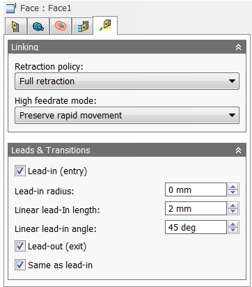

Linking tab settings
Controls how the tool should retract to the clearance diameter after every cutting pass. or just retract a short distance away from the job. The distance is determined by the Safe Distance value.
Full retraction
Minimum retraction
Specifies when rapid movements should be output as true rapids (G0) and when they should be output as high feedrate movements (G1).
This parameter is usually set to avoid collisions at rapids on machines which perform "dog-leg" movements at rapid.
The feedrate to use for rapids movements output as G1 instead of G0.
Enable to generate a lead-in.
Lead-in
Specifies the radius of the lead-in move at the start of a cutting pass.
Lead-In Radius @ 0mm
Lead-In Radius @ 3mm
Specifies the distance (length) of the lead-in move at the start of a cutting pass.
Linear Lead-In Distance set to 1mm
Linear Lead-In Distance set to 5mm
Specifies the angle of the lead-in move at the start of a cutting pass. Note that the angle reference depends on the Use fixed lead direction.
Lead-In Angle @ 45 degrees
Lead-In Angle @ 90 degrees
Enable to generate a lead-out.
Lead-out
Specifies that the lead-out definition should be identical to the lead-in definition.
Specifies the distance (length) of the lead-out move at the end of a cutting pass.
Linear Lead-Out Distance set to 1 mm
Linear Lead-Out Distance set to 5 mm
Specifies the radius of the lead-out move at the end of a cutting pass.
Lead-Out Radius @ 0mm
Lead-Out Radius @ 3mm
Specifies the angle of the lead-out move at the end of a cutting pass. Note that the angle reference depends on the Use fixed lead direction.
Lead-Out Angle @ 45 degrees
Lead-Out Angle @ 90 degrees
