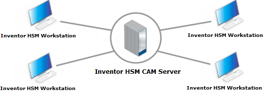

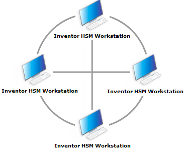

Distributed CAM allows you to utilize your workstations more efficiently. You can use Distributed CAM in different configurations as shown below.
Utilizing a single powerful workstation to speed up calculations on four other workstations
Sharing all workstations to speed up calculations

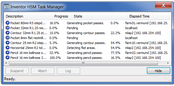

The Inventor HSM Task Manager with the Server column enabled showing which workstations are being utilized. In this case, the toolpath calculations are running on four different workstations plus the local workstation.

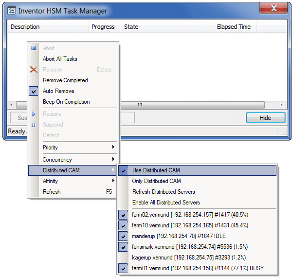

Distributed CAM is automatically used when available. You can turn Distributed CAM on/off manually from the Inventor HSM Task Manager right-click context menu if required. Distributed CAM keeps track of all the available processing resources which allows it to choose the best workstation on which to offload the toolpath calculations.
The Distributed CAM menu
