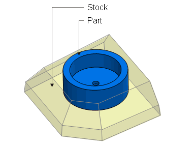

Adaptive Clearing supports stock definitions of any shape.
Irregular stock
  1. In Inventor, create the stock as a separate solid body.
  2. In Inventor HSM, create a new setup and select the created stock.

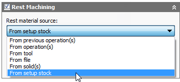

  4. Enable Rest Machining and set the Rest material source to From setup stock.
    Rest material source from setup stock
