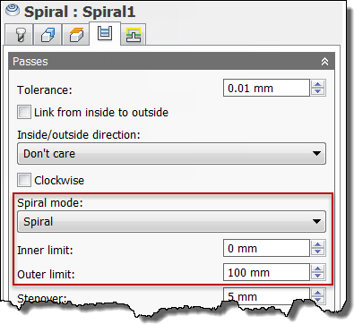

The Spiral Finishing strategy offers several different modes of operation. The mode is selected from the Spiral mode drop-down list located on the Passes tab.
Selecting Spiral mode
