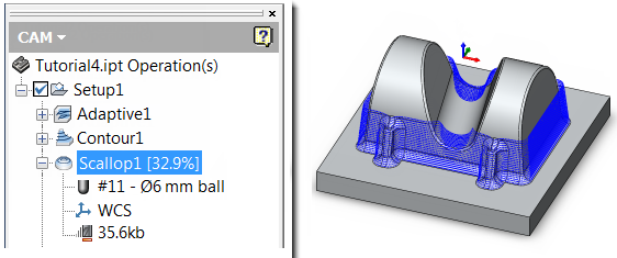

You can preview and simulate toolpaths in Inventor HSM while they are being calculated. If you have a toolpath that is taking some time to calculate, you have the option to continue working by clicking the Hide button in the Task Manager (if it is visible).
If you select a calculating operation, the preview shows the toolpath generated up to that point. This can be very useful for spotting incorrect parameters early in the process - like an incorrect machining boundary - without having to wait for the calculation to complete.
Preview for a partially generated Scallop toolpath
