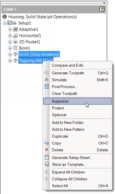

  1. Right-click one or more operations from the CAM Browser.
  2. Select Suppress from the pop-context menu.
Suppressing operations in the CAM Browser

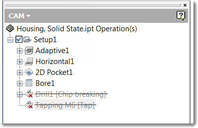

A valid toolpath is cleared when an operation is suppressed and a warning message is displayed. The suppressed operations now appear in the CAM Browser using a dimmed gray color and a small red 'x' indicating that the toolpaths are invalid.
Suppressed operations Drill1 and Tapping M6 are shown dimmed
