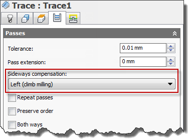

Trace allows you to compensate the tool to the left and right of the selected contours.
Sideways compensation direction
This works like the compensation direction parameter available on the 2D Contour and Multi-Axis contour strategies, and offsets to the left or right of the selected geometry, while still obeying the changes in Z.
