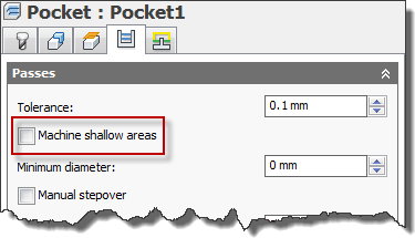

The Machine shallow areas option appears on the Passes tab on fixed Z-levels strategies, such as Pocket Clearing and Contour Finishing. This option is useful on parts that have both steep walls, as well as areas or pockets which are almost flat (shallow areas).

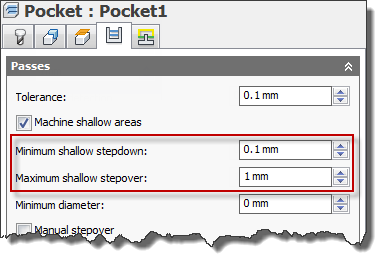

Activating the Machine shallow areas check box reveals the two controlling parameters:
Shallow areas settings
Minimum shallow stepdown:
This parameter controls the minimum allowed stepdown between the extra Z-levels and takes precedence over the maximum shallow stepover.
Maximum shallow stepover:
This parameter controls the stepover used to detect areas where extra Z-levels should be inserted. If the normal stepdown results in a stepover of more than this value, extra levels are inserted until the stepover or the minimum stepdown is reached.
