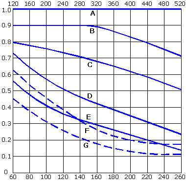

Reduction in endurance limit due to surface finish (steel parts).
Hardness (HB)
Tensile strength Su (ksi)
| where: |
| A - Mirror-polished. |
| B - Fine-ground or commercially polished. |
| C - Machined or cold drawn. |
| D - Hot-rolled. |
| E - As forged. |
| F - Corroded in tap water. |
| G - Corroded in salt water. |
