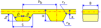

Belt with trapezoidal teeth
| Symmetrical double-sided teeth | Staggered double-sided teeth |
Pitch belt length can be determined as
L = z p b

Meaning of used variables:
| z | Number of teeth of given pulley/ Number of belt teeth [-] |
| p b | Circular pitch [m] |
| a | Pitch line offset [m] |
