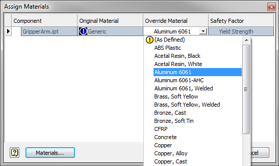

With Shape Generator, material properties must be assigned to define the structural characteristics of your part. Available in Inventor 2016 R2 - Subscription customers.
Most importantly, the material assignment will affect the density used for mass calculations. The structural properties are accounted for by Shape Generator, but because the percentage mass reduction is the user-specified goal, the structural properties may only have a minimal effect on the generated shape.
 Material
		panel, click
		Assign
		Material
		panel, click
		Assign
