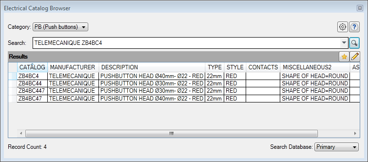

If the Electrical Catalog Browser is not open, click Assembly tabComponent panelPlace drop-downElectrical Catalog Browser.
Select the category for the type of part you want to insert.
Enter a search criteria and click .
Click the catalog value in the results pane and a small palette appears. If there are any parts associated to the catalog value they are shown on the palette.

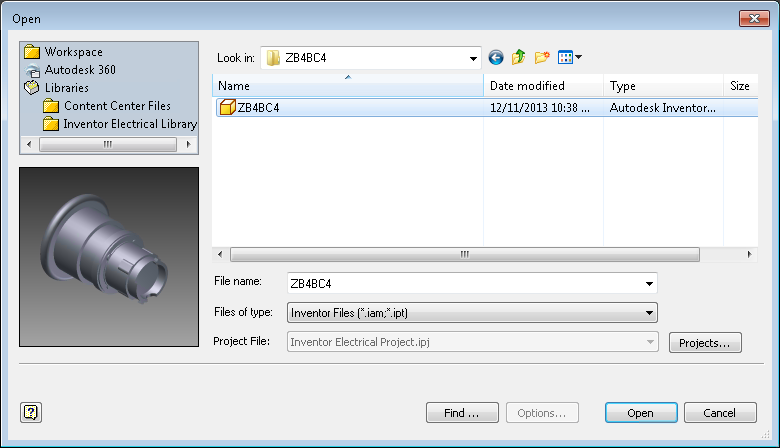

Do one of the following:
Click a part on the small palette.
If the part you want is not available on the palette, browse to locate the part on disk.

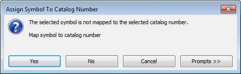

If the part is not already associated to that catalog value, select whether to map the symbol.
