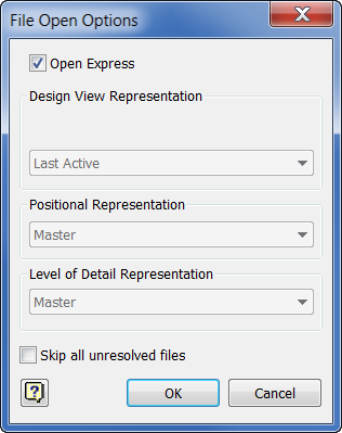

Use File Open Options
Some commands are not available in Express. If a required command is not available, Load Full.
