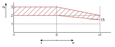

The recommended minimum value of safety factor at fatigue loading is indicated in the n f =<1.5...3> range and it depends on the fatigue loading pattern. In general, reversed loading is less favorable than fluctuating loading when the fatigue loading of weld joint is considered.
The following image illustrates the effect of loading course to weld joint safety. The range of recommended minimum values of safety factor, which depends on the value of cycle asymmetry factor r = σ n / σ h , is hatched.
