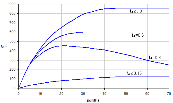

Wear factor f C
Wear factor takes into account quality of lubrication and how much it has an impact on the chain wear progress. The size of the wear factor is determined from the following chart with respect to size of lubrication factor f 4 and bearing area pressure p B .

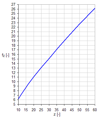

Teeth factor f Z
The teeth factor takes into account modification of service life caused by size of the smallest sprocket in the chain drive. The size of the factor is defined by following chart.

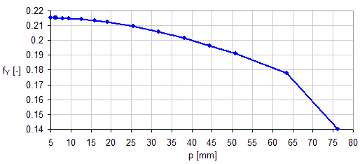

Specific chain size factor f Y
The factor takes into account chain size with respect to peak overloads. The size of the factor is defined by following chart.
