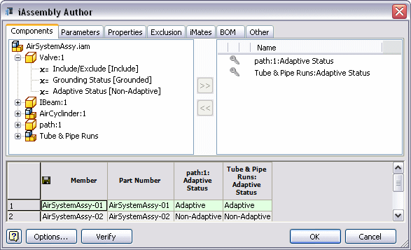

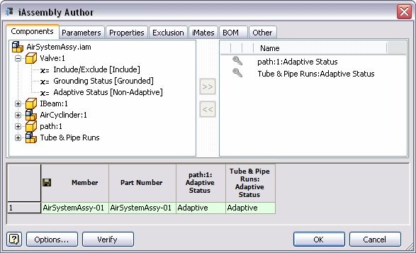

  4. On the ribbon, click Tube and Pipe tab iPart/iAssembly panel iPart/iAssembly Author .
    File name of the master runs assembly is displayed in the candidate objects list, by default, Tube & Pipe Runs. The adaptive status is automatically selected into the configuration table.
    Note: Configuration row in green indicates the active configuration.
  5. Optionally, click Name to customize the part number and member name for assembly configuration. In this exercise, use the default naming schema.

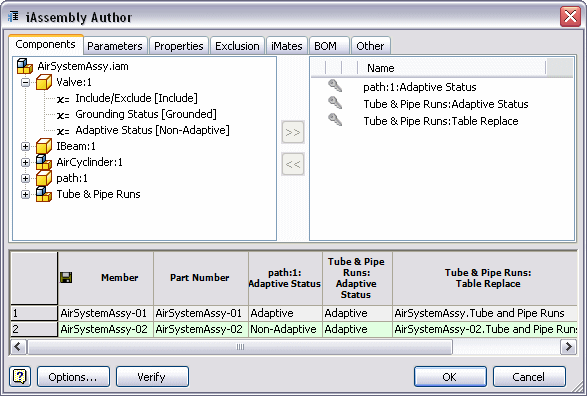

  6. In the configuration table, right-click a row number and select Insert Row.
    A new configuration is created, AirSystemAssy-02. By default, the master runs assembly is non-adaptive as indicated in the Tube & Pipe Runs: Adaptive Status column.
  7. Click OK to close the iAssembly Author dialog box and save the top assembly.
  8. In the Model browser, expand Table and double-click AirSystemAssy-02 to activate the new configuration.
  9. With the top assembly active, right-click the master runs assembly and select Make Adaptive.
  10. In the Make Adaptive dialog box, determine whether to select or clear the Make all runs adaptive check mark and click OK.
  11. Edit routes and runs in the active configuration as needed.
  12. In the Model browser, double-click Table and verify the following for the master runs assembly:
    • Adaptive Status column has a value of Adaptive in the new configuration.
    • Table Replace column is added to the configuration table.
    • The tube and pipe interchangeability set is initiated with two master runs assembly members so it can be swapped in for the desired configuration row using the Table Replace drop-down list.
  13. Repeat Step 6 through Step 12 to add more configuration rows and include more adaptive master runs assembly members into the tube and pipe interchangeability set.
  14. Optionally, to swap in another tube and pipe interchangeability set member for one configuration, click the appropriate Table Replace cell and select a specific master runs assembly.
